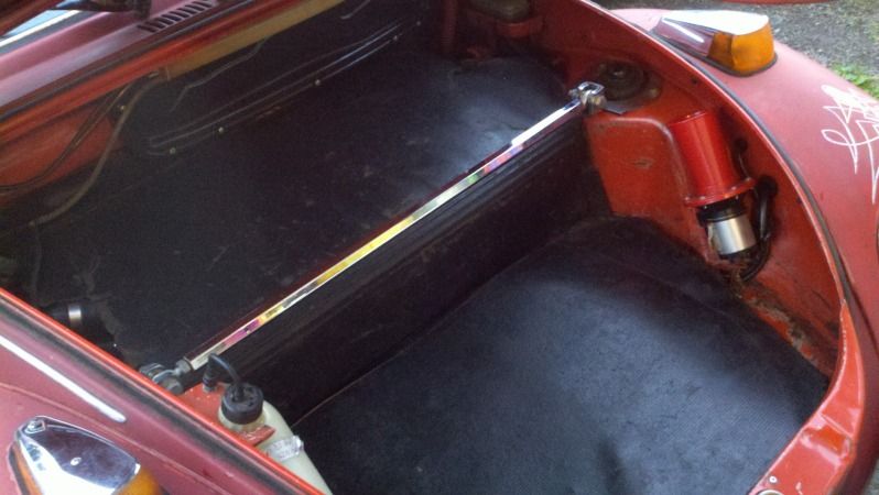

But the best addition I made to the front end was the Strut Tower Brace.
That made the biggest improvement for me, even after all the other stuff was added.
I noticed the difference on the first drive and it was night and day.
