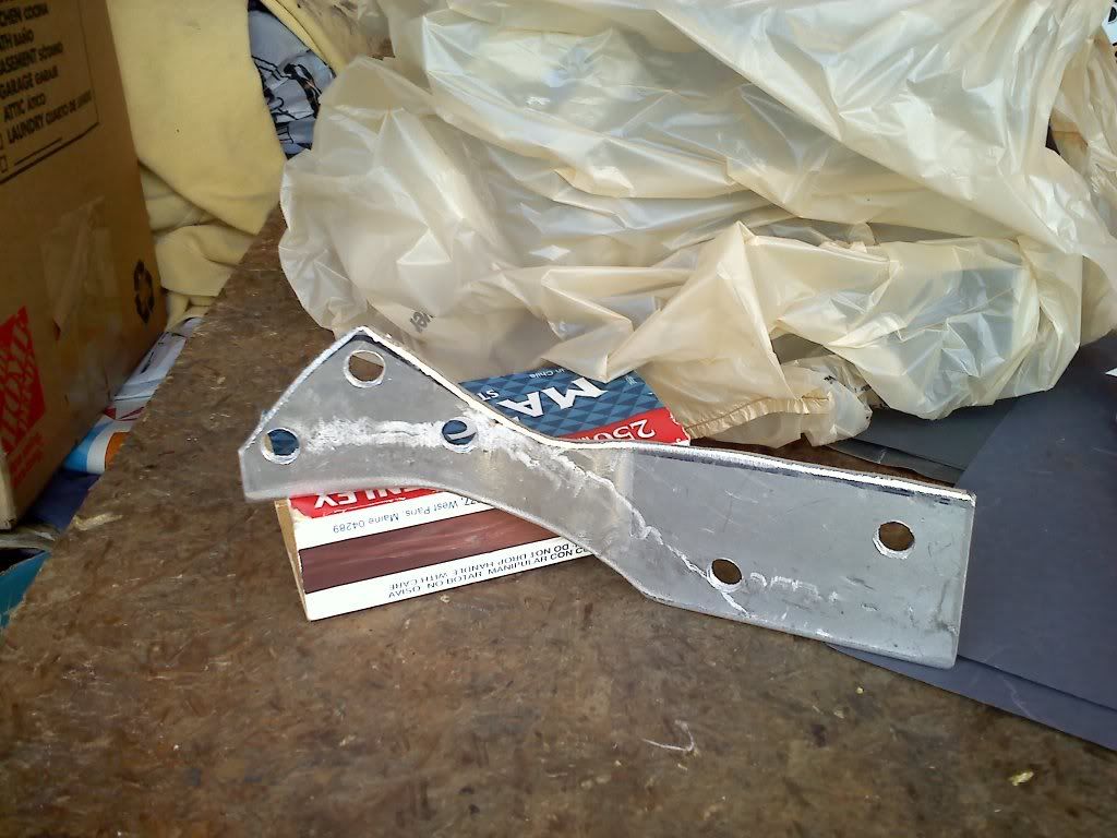

Post by: Kev on September 20, 2011, 06:33:18 PM
Motor is in...
Needs a bit o work still, electric fuel pump, etc...
Oh Lord, I Pray that this thing will run...
And a one of a kind oil filter bracket by me...

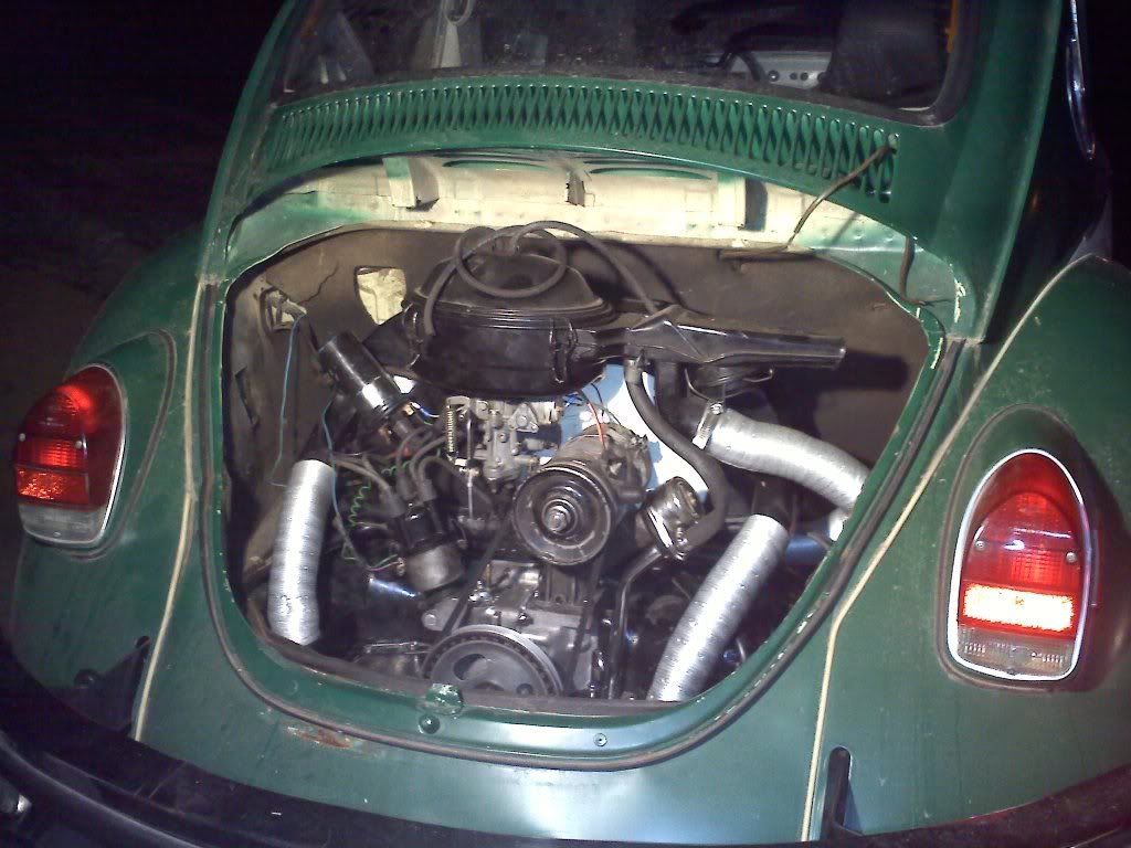

Post by: Revs71 on September 20, 2011, 09:11:59 PM
I realized I created this post and then never posted it.
Tins and exhaust on
and in the car.....
Anyone want to recommend a good fuel pump brand and/or location for an early superbeetle?  Any tips on set-up?  If I am not mistaken It needs to be about 2.5 lbs of pressure.  I assume it needs to be wired in so it is only powered when the key is on....I have a couple of accessories I have done like this so this shouldn't be a problem.

Title: Re: Revs 71
Post by: Kev on September 24, 2011, 05:25:03 PM
Cool, glad it worked!  Did you have to reverse it because of the bumper bolts?  Nice wire job.
Title: Re: Revs 71

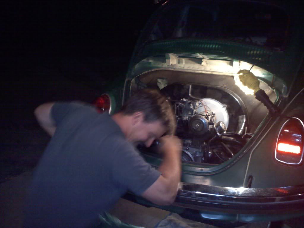

Anyone have any ideas what the sort of audible sound in the not so great video is?
A problem came a rocking, a knock, knock, knocking (http://www.youtube.com/watch?v=dhpcIVdyVPw&feature=player_detailpage#)
Well, duh, somebody put the engine in upside down. They always sound like that upside down 'cause the oil falls away from the pickup. Install engine right side up. If it still sounds like that, there's something wrong with it

I just listened to both videos again.  Check your rocker arms! Based on the sounds from the first video (it's alive) I'm guessing the push rods for one or more valves popped out of the cups at the rocker arms.

So...no problem on 1 and 2 so I moved on to 3 and 4 and
VIOLA!!!    :2down:
I fixed it up, tightened down the rocker arm and went to adjust the valves....noticed the rocker wouldnt move a bit.....more investigation and ......AHA!   :lame:
I screwed the head stud in a bit more....problem solved....I hope.  I am thinking that this valve being unable to operate may also explain my lack of power.  We will see...I think I am going to start it up tonight.

Wow!  I guess my hearing hasn't gone out on me!  I based my assessment on hearing what sounded like really loose valves in the first video and stuck valves on the second.  The bit that sold me on the problem was the part where you mentioned that Kev helped assemble it.   ;). Just kidding Kev!

you know what they say about necessity....homemade distributor drive puller

Here is my new dilemma..I actually got the car to idle today!  But it was backfiring real bad out of the 1/2 side...any thoughts....I am (reluctantly) running an 009 style distributor because my kads aren't ported for vacuum advance or I would run my svda.  I have a new coil, newish condenser, and new points...My timing is just static set at 0 to get the bad boy to start but I did play with it a bit to get it to idle (i advanced it a touch)
I am wondering about the backfiring...I have never had this issue before so I am unsure what to tackle.  The car would choke and sputter at first and not want to idle for more than about 5 seconds.  I was able to feather the throttle to get it to idle but then it was backfiring on 1/2 every few seconds like I said so I shut er down.
Any thoughts?

Much grass...I'm going to flip the carbs to determine if it's a carb issue or if it's a valve/intake issue. We'll see...
Title: Revs 71
Post by: BuginU2 on February 20, 2012, 02:28:12 PM
First - do a complete valve adjustment now that your motor is back together and running (somewhat).  You probably won't need to adjust anything,but it is good to check anyway.
Second, make sure your intake and exhaust manifolds are torqued down enough.
Third, adjust the linkage so that both carbs hit their wide-open stops at the same time.  Adjust the air/fuel mixture to about 2 turns to start with.
Fourth, when idling set the timing to about 8 degrees.  When you rev the engine above 2800 rpm, the timing should be no more than 28 degrees advanced.
Take a video of the engine running again....

    • Remembering I knew my problem would be something "simple"...I noticed today it was loping on the idle which led me to check for vacuum leaks....guess what I found where the manifold meets the head
    Next step is to get a new gasket and to retorque the intake on that side then to sync the carbs and see where we are
Make sure the base of the manifold that mates with the head is flat. Some heavy-handed DPO may have warped it when he or she torqued the nuts too much.
If it isn't flat, it can be "home milled" flat. Use a piece of abrasive paper on a very-flat surface. Piece of glass works well. I use a large, marble tile from Ho' Depot.[/list]

I fixed the intake....Took it off, painted it, reinstalled after replacing the stud in the head that just wasnt quite right.There is a noticeable different in smoothness of idle and willingness to rev without sever popping....still some backfiring out of the carb but I think its because I need to get both the timing on the 009 set up right and I put a sync tool on the carbs tonight to see how close they were and 3/4 is at about 6 where 1/2 is about at 4...Im gonna read up on adjusting that tonight and get er done tomorrow.
Title: Re: Revs 71
Post by: Revs71 on February 29, 2012, 11:57:52 PM
Took off the 1/2 side carb and intake to fix a stud that was keeping the intake from sealing all the way...much much better now.  Everything is all back together now and the block off plates are installed.  I noticed a big drop in idle already which is good.
Also had to modify the little stabalizing lever for the linkage.  I was noticing a little "wiggle" so I wanted to secure it.  Works great with no hangups.
I also got the block off plates put on the heat risers so no more exhaust leak.  Car is idling well.   I still need to time it correctly and adjust the carbs properly but it's too late tonight.

Today I finally decided to craft some industrial tins to help with engine cooling since I am using J-tubes...I didnt save a ton of money doing it myself by I enjoyed the process.
Plans I found on the samba
Right side transferred
All Cut out
My Bending "Jig"
All Bent
Painted up -- install tomorrow!

Title: Re: Revs 71
Post by: LooseNuts on April 22, 2012, 09:19:22 AM
Sweet mang. Love seeing people fab there own stuff. :clap:
looks good.. :2up:
And think no matter how it turns out it can be worse the buying EMPI...
Title: Re: Revs 71
Post by: CatBox on April 22, 2012, 09:20:41 AM
That looks like a fun little project the man!
Thanks for sharing.
:2up:

Post by: jbjetta on April 22, 2012, 06:30:32 PM
Nice work on those tins. What thread on the Samba did you find that on? I'm interested in doing something like that for my bug.
Title: Re: Revs 71
Post by: Revs71 on April 22, 2012, 06:40:25 PM
Happy cutting and bending!  The left side didnt quite fit for my tin...I had to trim it about 1cm to fit.

Hi guys,
Let me refresh your memory about my car.......71 superbeetle with a 1600 sp engine , 009 dizzy, and dual Kads.
I have a little problem   ..... :lame:
I had this engine running like a top until I had did a little modification to the fan shroud which meant removing the carbs.
When I put the manifold back on the head stud on 3/4 came out of the head and so I replaced the head.   In process, a head stud pulled out of the case which cause me to have  to tear things down again and put in a case saver and reinstall the stud and the head....
We got everything buttoned up and back together and now, with timing set at 30 btdc at full advance (round 3000 rpm) carbs synced, mixture set, dwell right on, valves at .006.l...the car idles well but pops real bad beginning at around 2500 rpm.  I took it for a spin and it will get to speed eventually but  is seriously lacking the previous power.
Things I have  done:
I've run out of  ideas and am looking for some fresh advice.
Thanks for lending your brain power to my issue!
Here is a video for reference.  You can hear the pops toward the end... a little like a machine gun.
http://youtu.be/l8sTv4Vr6L8 (http://youtu.be/l8sTv4Vr6L8)

I pulled the plug and checked the spark at the #3 plug.....Good spark...
Checked compression on #3......0
Checked the valves....found my exhaust valve was tight Tight TIGHT!....Exhaust valve never fully closing
Reset the valves....compression back to normal....car fires up and sounds great
again..... :lame:
Mark....thanks for your help.

I am changing heads back to some old dependables because I think they may not be  seating right on the jugs.
I am chasing down some oil leaks and sealing them up.
And I found this in my drivers side Kadron - a crease. I think it explains much of my popping and sputtering when I was gently pressing the accelerator.
I thought I had an air leak but it turns  out the accelerator pump wasnt  smoothly going through its range of motion...it would stick until the spring finally had  enough force to actuate the diaphragm.

I discovered that the arm that works the accelerator pump had a slight bend in it and was hanging on the opening in the pump...pliers and a file solved my issue.
I got the car totally switched over to SP heads, idle/mixture all adjusted and timing reset to 32 degrees at full advance...Car is running like a champ again! :headbang:

soooo,  I've been thinking about fixing a fender for a while now and have had this one lying around for about 3 years.
Finally dug in last night with a heavy duty stripping wheel and a sander.  Everything is cleaned up and feathered nicely.
Need to throw on some filler, sand a few times, then slap on some krylon.
It will be nice not to have a cross-eyed car anymore   :grin:

Post by: Revs71 on June 19, 2016, 10:26:13 PM
Finally getting something worth posting again....
I had a great year at the bug run.  Picked up some fenders for the '63 and found a frame from a 50's era Allstate single wheel trailer for a price that I couldn't pass up.
The Wheel bearings have been a bear to find but I finally got em pieced together.
I found brackets too but the guy wanted almost as much for them as I paid for the trailer...so I decide to make my own.
I also put this together in the last few months....it was a nice diversion
